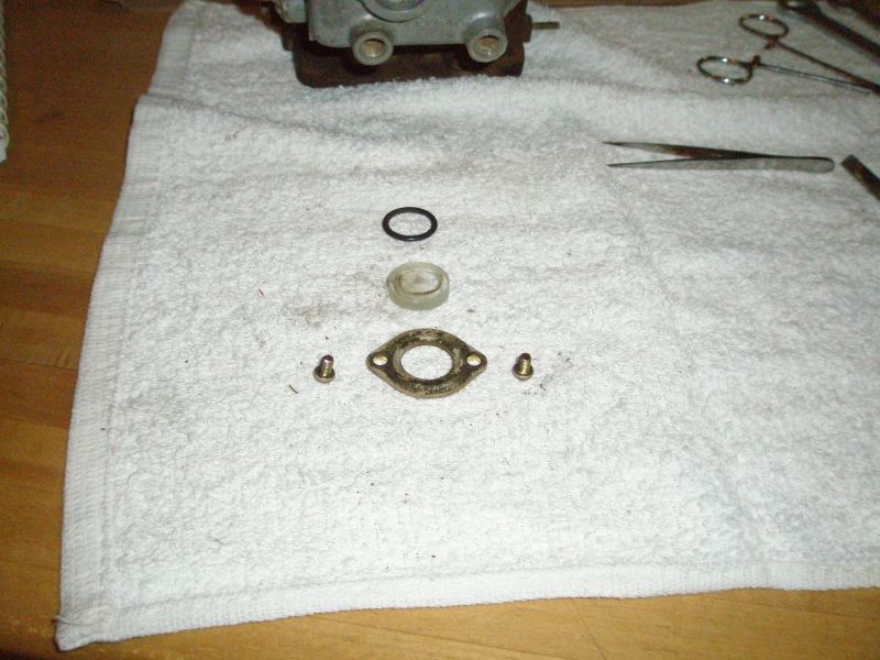

Removing the sight glass is very straight forward. Just remove the two screws and push the pieces out from the inside with a finger. The sight glasses came in plastic and glass; there are specific gaskets for each and they are not interchangeable between the two. My carb had a glass and it had a chip.
