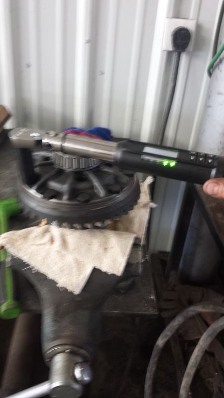

70 Ft Lbs on the ring gear bolts.
[IMG][/IMG]
