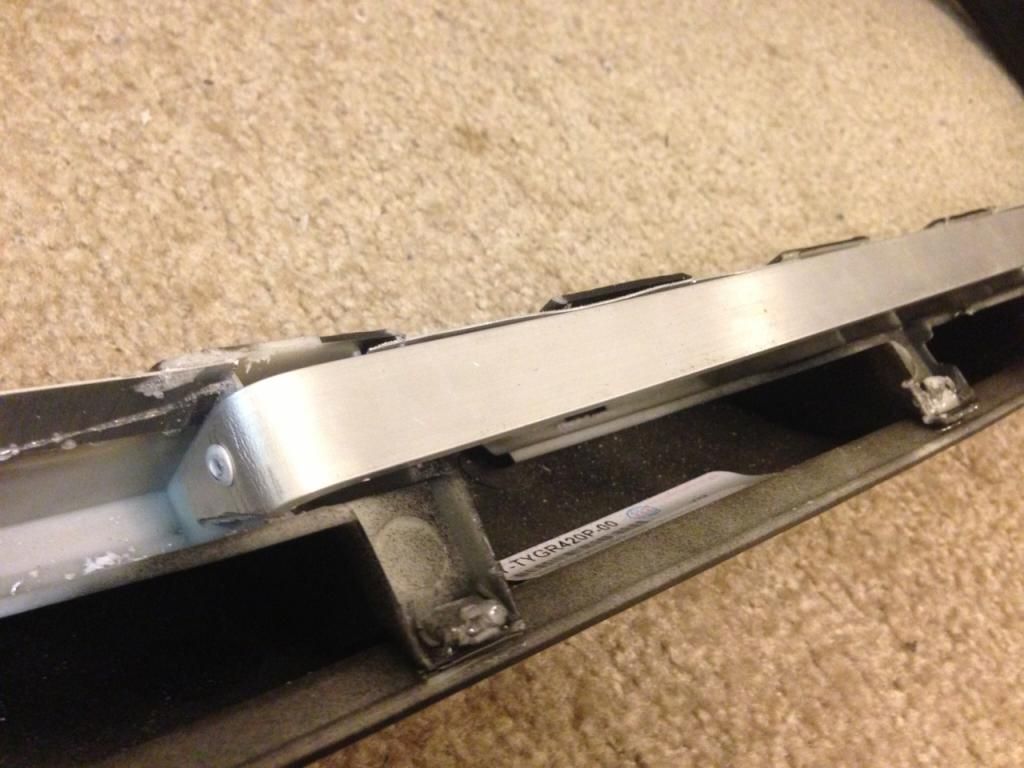

I then made a special 16" long bracket from aluminum spanning the top of the grill. I glued and riveted the bracket to the grill. It had to be bent to match the curve on the grill.
[IMG][/IMG]
