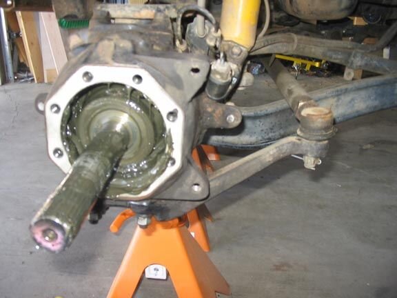

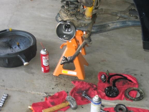

Pretty weak turnout at the WBPP today, where were you guys?
Anyhoos, at this point I've got one side completely taken apart and cleaned up. Thanks for the tips so far...

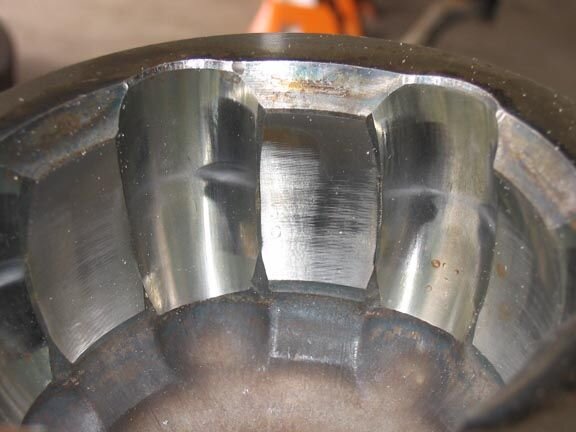

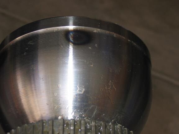

Do my wear marks on the inside of the birf look pretty normal? Would it be a good idea to switch sides? I plan on upgrading to Longs in November when I regear, so this only needs to work well this summer, then as a spare.
Also, are those burm marks on the outside normal? That's from when they machined the bearing races, right? and not indication of really hot balls...
North siders, got lots of here if you're feeling wrestless come on up. Anyone have an extra snap ring for the inner axles (goes inside birf). Also anyone have an extra big seal, that one that goes against the dust shield? I'll be reusing both of those if not..
Last comment is I discovered some decent grooves on the OD of the spindle, where that seal rides. Anyone seen that before? The seal itself actually looks fine, so wtf?
The burn makes are from the heat treating process. The wear is normal. 80 circlips usually don't break when seperating the birfs so they don't need to be replaced. You can drive the new seal in a tad further than just flush or don't worry about it (if the seal didn't leak before you'll probably be OK) And please.....your "hot balls" are way more information than we need!

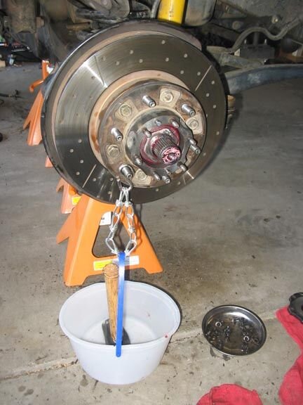

So almost back together now.. final question. I've always thought the fish scale deal was a little goofy, but today really wanted to measure my bearing load. The guy at AutoZone in Laffyette had never heard of a fish scale, so resorted to fabbing my own.
I'll give the plastic ice cream bucket & chain 1 pound. So here it is below, with my 4 lb. hammer in it, after it genly coasted down to the ground. My 24oz. hunting hammer will stay suspended in the air, but anything more than that will make it spin. Well, crank the adjusting nut you say.. since the FSM calls for 6.4 to 12.6 (SA-11). But I've already cranked it back to the 47 ft pounds I cranked it to twice to set the preload. If I didn't have the scale, I'd say this bearing is way too tight. But with the scale, it's way to loose.
So I'll take a vote of everyone on line today- trust my instincts, or trust the scale? I'm going to do the other side now, see if I get the same results...
