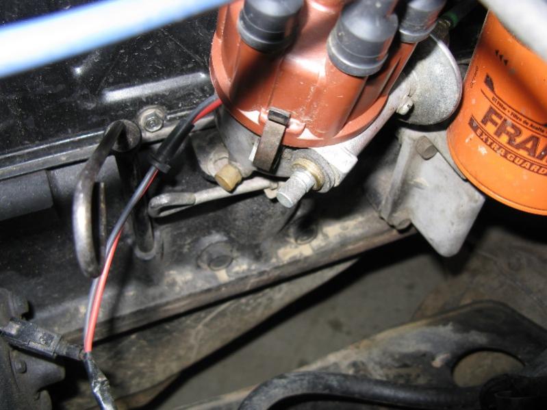

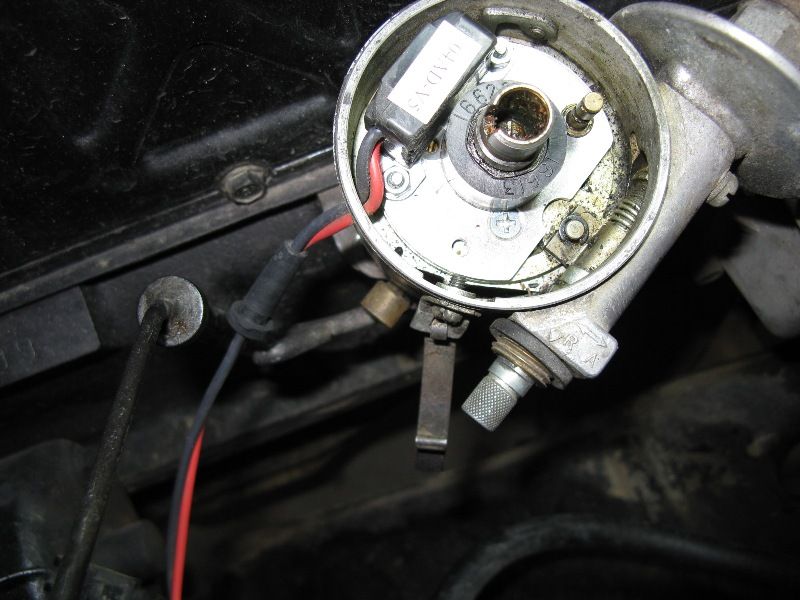

Distributor is original, new cap, rotor, wires. Points have been replaced with electronic points... vacuum advance seems to work,

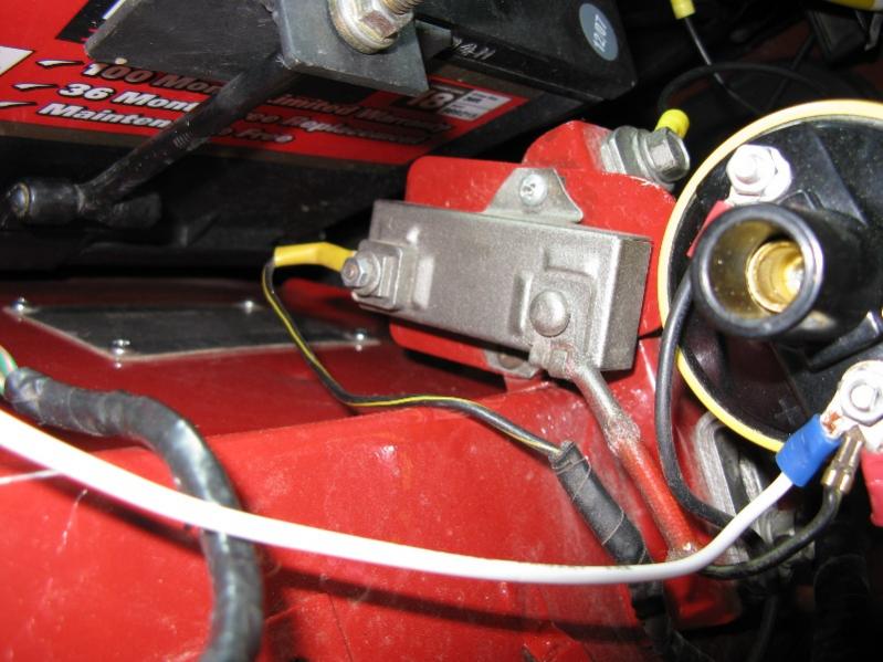

Thinking through the ignition ground; the ignitor should be grounded because it is mounted on a metal bracket which is attached to the metal fender, which is attached to the metal body, which is attached to the metal frame, which is attached to the battery ground - each attachment point could be the source of a problem. To make sure the connection is good and reliable I took a "belt and suspenders" approach to holding my britches up and ran a ground connection directly from the ignitor/coil bracket to the battery.

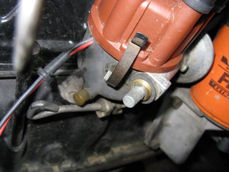

The mechanical advance is working on the distr. but although I DO have vacuum at the carb TO the distr, It is not advancing the timing upon acceleration.
So, at least THAT is not working on the distr.
It seems to be tight in place and very clean on the inside. has an electronic box in place of points.
What is the function of the "igniter"? Can this be causing a problem? How would I check it?
I think your'e right, may need to try a known good distr....
