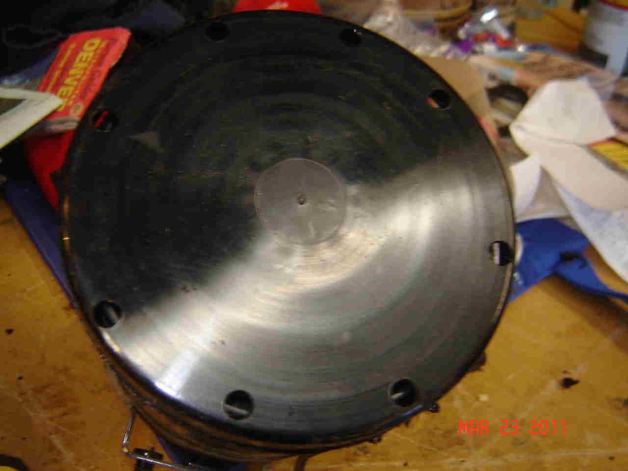

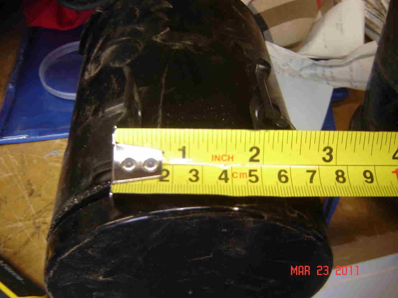

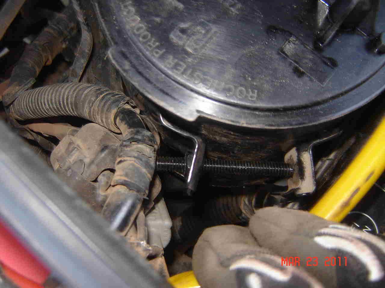

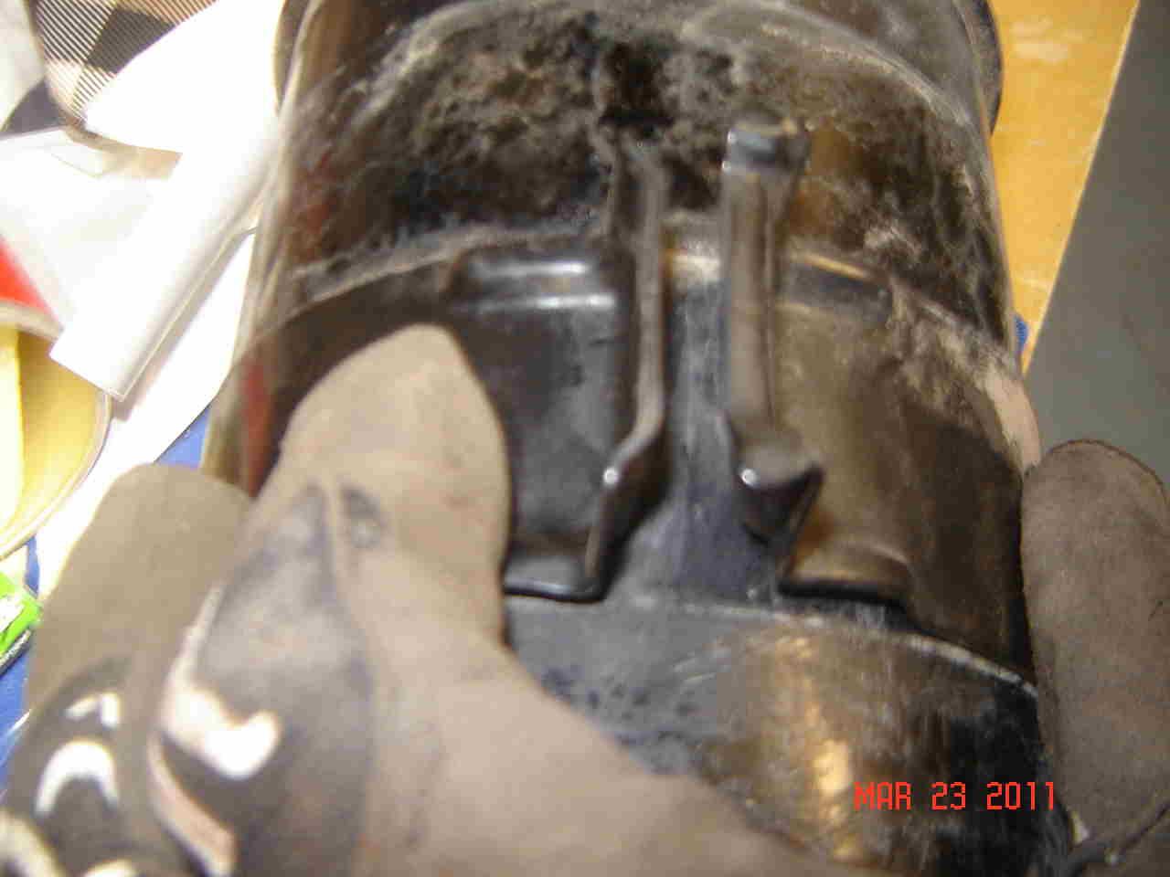

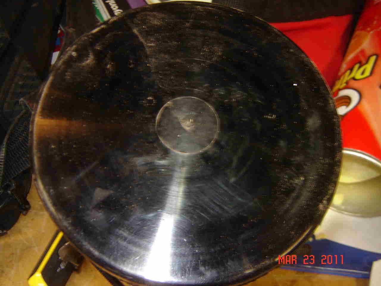

1. About how close the bracket closes on OEM Canister (the ends touch when tightened).
2. About how close the bracket closes on replacement aftermarket Canister.
3. Bottom of replacement aftermarket Canister as delivered.
4. Bottom of replacement aftermarket Canister as drilled for drainage.
5. Replacement aftermarket Canister installed showing 2.5 inch bolt.
