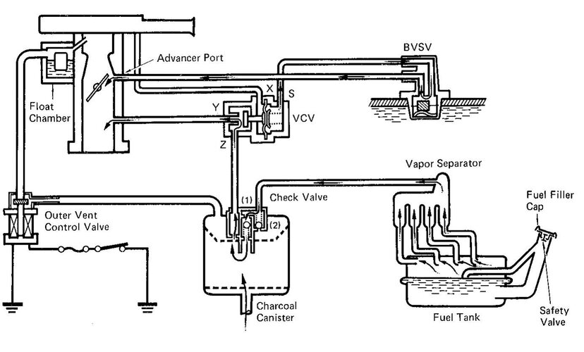

Questions regarding the Charcoal Canister.
1. Do I need it with a de-smogged 2F engine?

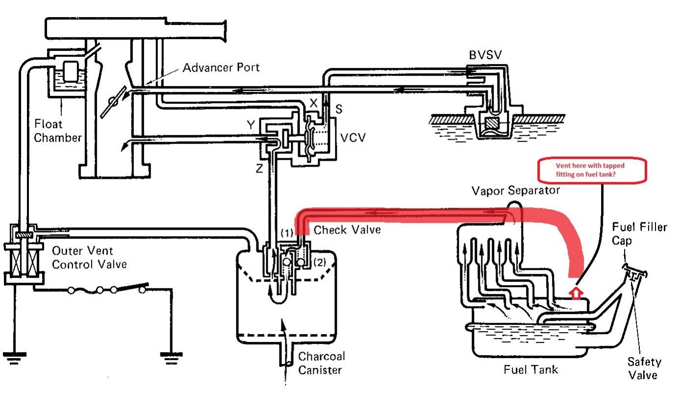

2. I figured out where the line with the "green" plug goes (in post #12) but where do I route the two other black hoses on the top of the canister? This is a 1964 FJ40 that only has a "fuel fill vent" and no vapor seperator.
3. It appears that I need to source a "Vapor Seperator" or tap a new line into the gas tank. Is any of this worth the effort?
Picture #1: My stock gas tank

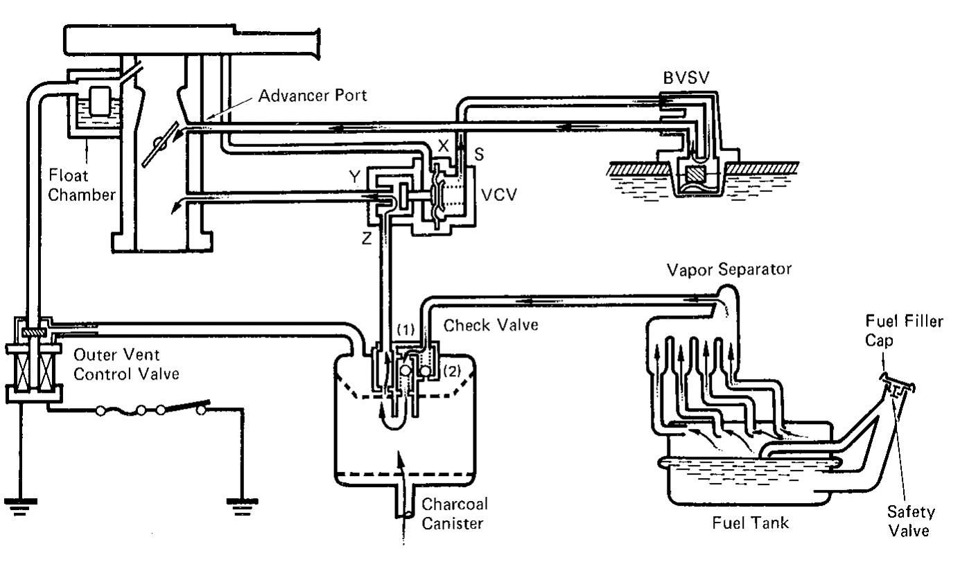

Picture #2: FSM Manual

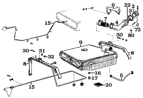

Picture #3: FSM Manual with modifications
