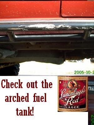

Well, Chili, I can't remember anyone accusing me of doing things the "right way."
I don't think my tank is much (more) bent than it is in this image:
[attach]bent fuel tank.JPG[/attach]
