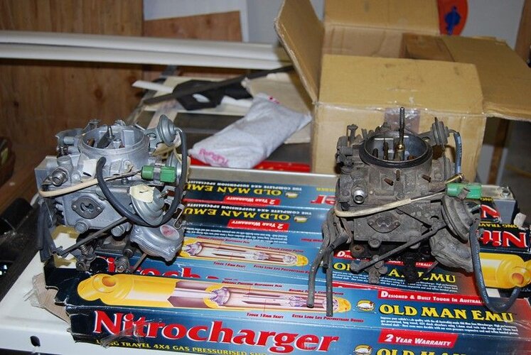

I took a stab at replacing the carb, and to my pleasant surprise, it's reeeaaally easy. But here's a little writeup anyway.
Prep and parts:
Started with a cold engine and collected the following parts and tools:
Parts:
replacement Carb
extra Vacuum line
masking tape and Sharpie
Tools:
12mm Stubby for the carb base nuts
12mm socket/rachet for the Air Cleaner brackets
17mm open end wrench for hard fuel line to carb
Phillips head screwdriver for the choke cable screw.
Here's what you get when Jim rebuilds the carb(the pretty carb, and notes on what he did):

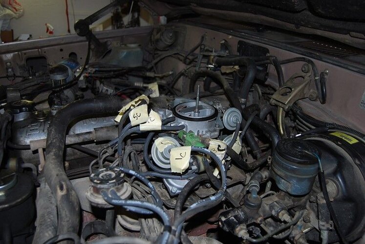

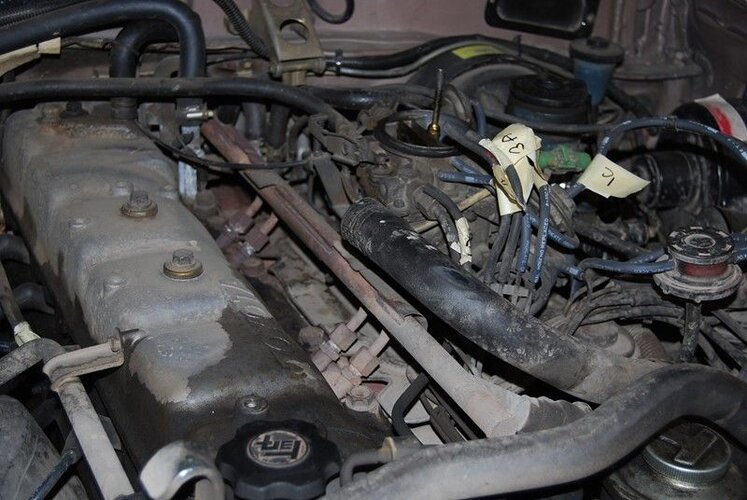

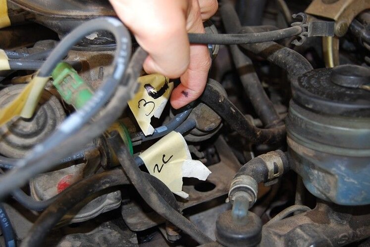

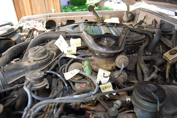

Default Carb replacement Phase 1
1. take lots of pictures from all kinds of angles
2. Start labeling the vac lines. I indicated lines to the Carb with a "C", and to the Air Cleaner with an "A". (1A, 2A, 1C, 2C, etc.).
3. mark the corresponding places on the new carb and on the Air Cleaner
4. Remove Lines being mindful of ones in cruddy condition. Replace as necessary. (hint:there's one hiding under the Air Cleaner)
5. Remove entire Air Cleaner assembly.

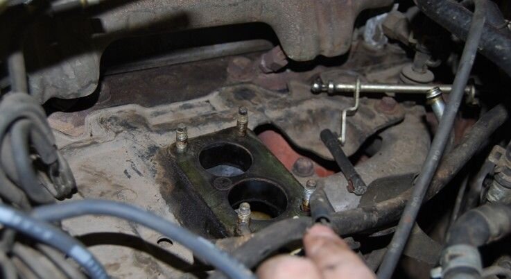

Default Carb replacement: phase 2
At this point, we'll start removing the carb:
1. remove choke cable. It's on the back of the carb.
2. remove linkage from the little snap on ball on the carb. Not sure if this helped, but I removed the little cotter pin further up the linkage to reach it better. Watch out, there's a spring there.
3. remove (4) 12mm nuts from the carb base. Stubby wrench is what you need.
4. pull off carb. (I was conscious of debris and stuff at the bottom. be careful.)
5. grab the gasket between the Air Cleaner and carb for the new one.
I was getting greasy at this point, just a pic of 'no carb'.
