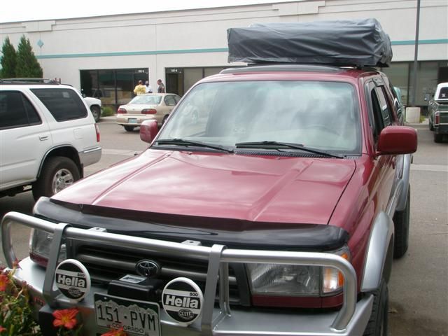

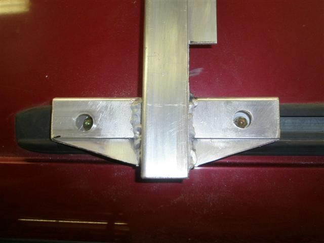

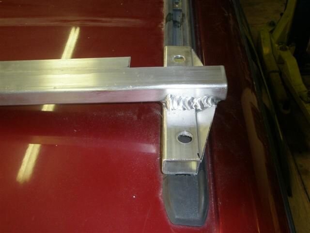

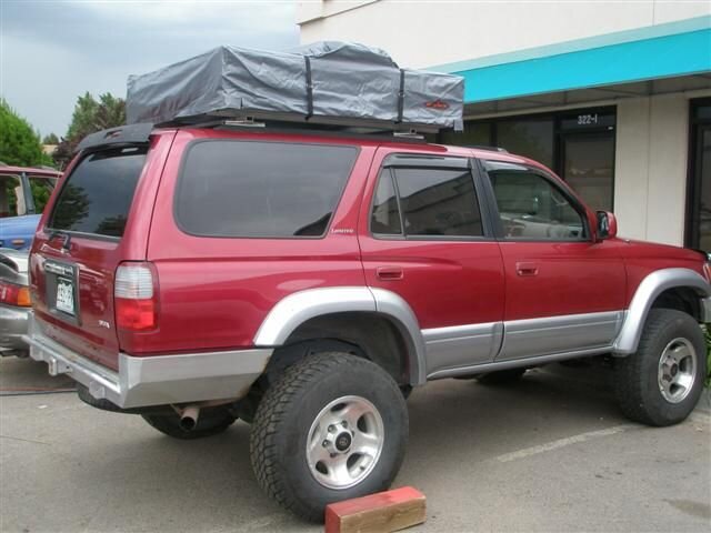

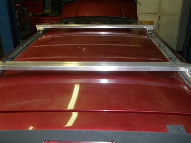

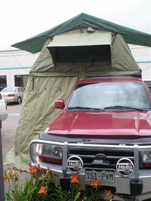

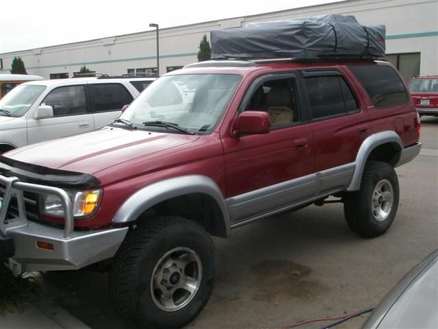

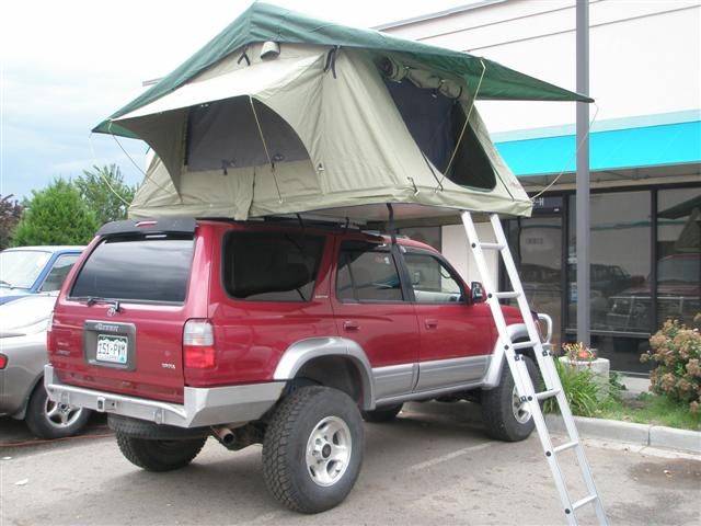

We purchase Roof Top Tents right before I got sick and we finally found the time to put them on. The 4 Runner roof is not as strong as the Land Cruiser one and we had to reinforce the existing luggage rack rails from inside and tried to build the frame for the RTT set-up as low as possible. After the reinforcement on the roof was done we welded a few aluminum cross bars and brackets and I think the entire project came off light, strong and low profile.

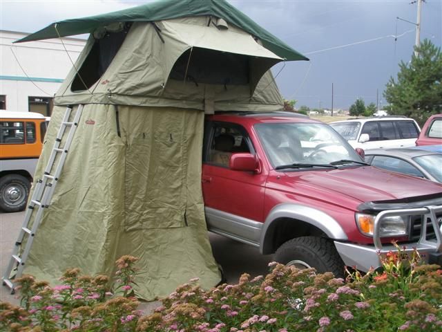

Here are more pictures.

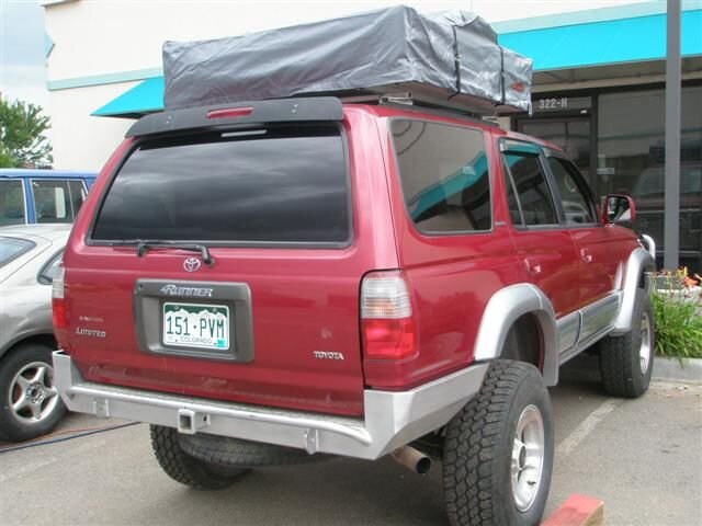

Just a few more.

Very nice, Oleg! It's nice to see you back in action, even if it's not 40 hours/week.

That's a sharp 4Runner. I really like the low mount for the RTT. Nice work!

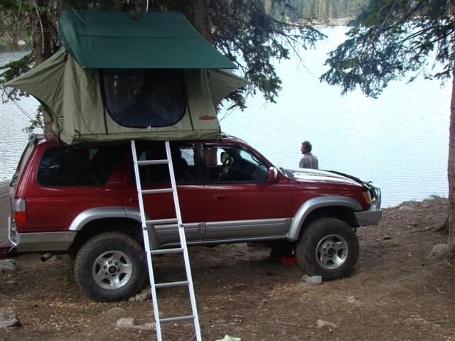

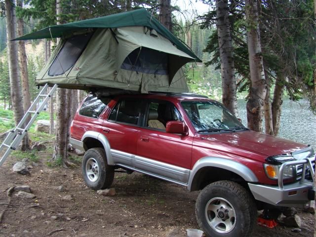

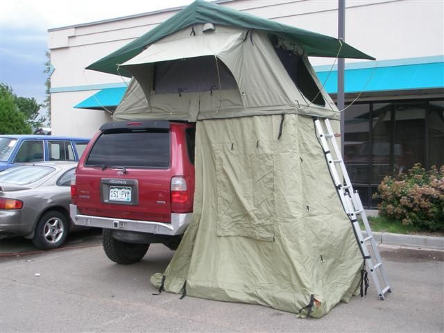

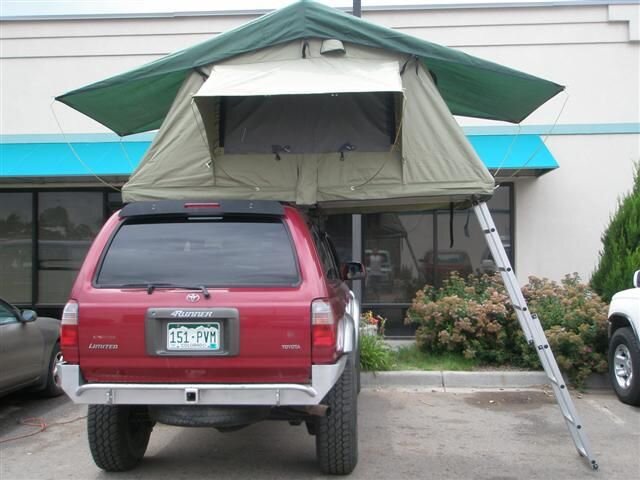

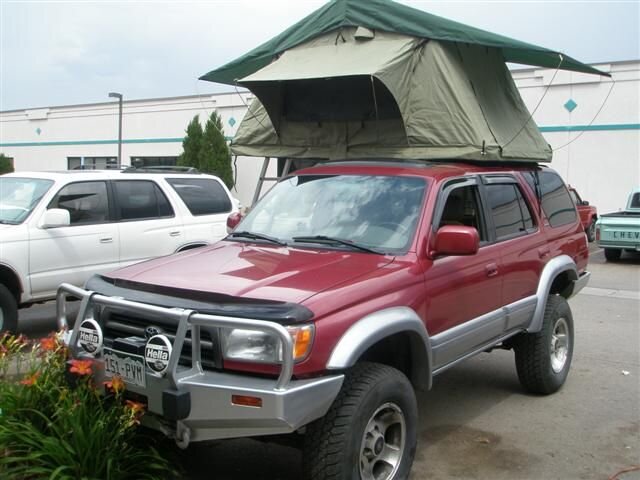

Here are some field test pictures.
