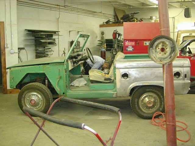

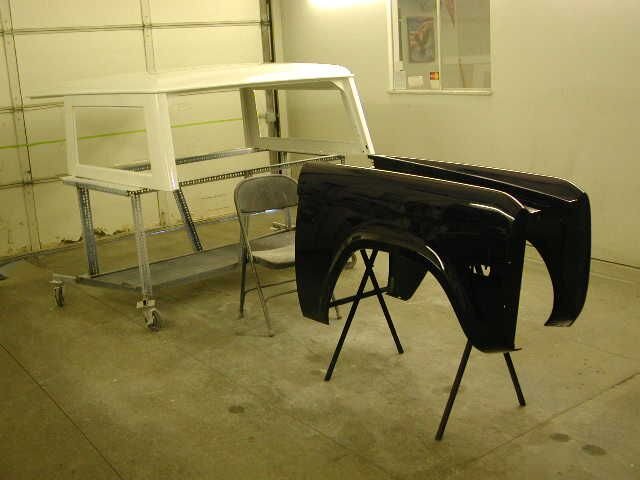

This is some pictures from a few years ago... Its now done.... Primsmatic paint, 347 stroker. looks stock otherwise
